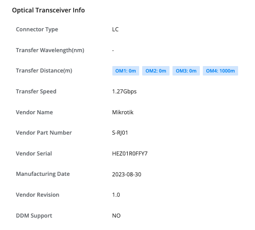

my current go-to SFP adapter for 1GB networks is the Mikrotik S-RJ01.

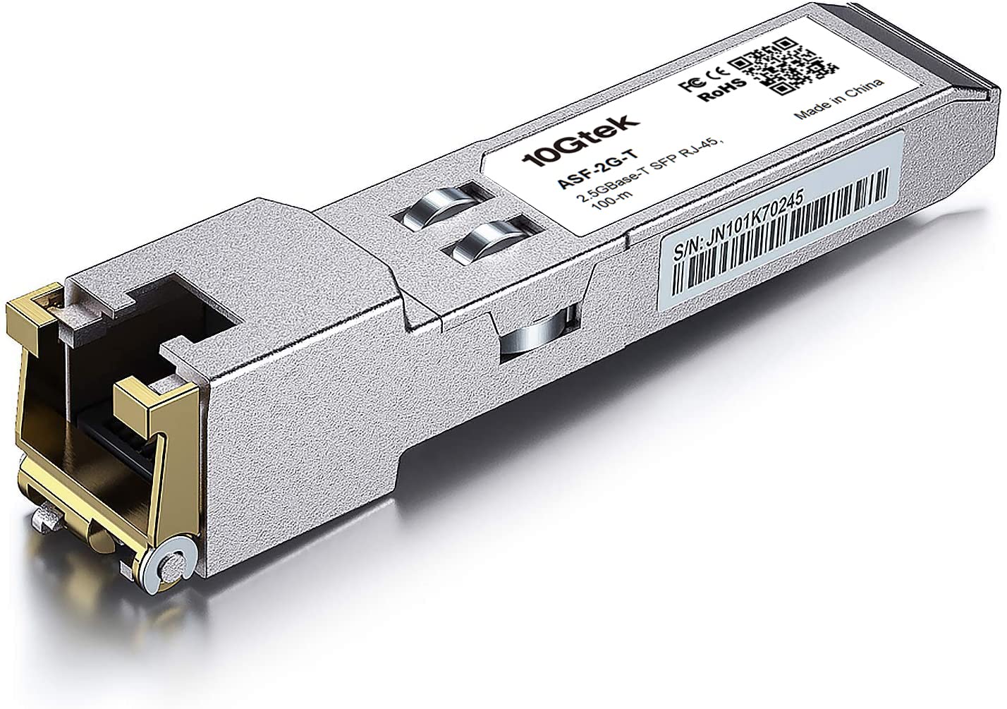

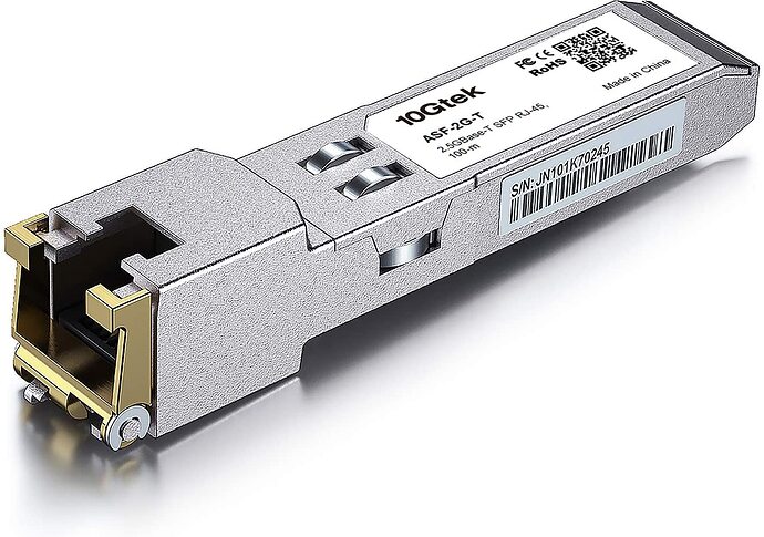

I have had good luck with the 10gtek brand of sfp/sfp+ modules. Cheap on Amazon. Grandstream SFP and SFP+ modules are available now too but don’t see a 2.5Gb one.

I tried this adapter and cannot get it to work any ideas ? I have archtop Fiber and the ONT box has a 1g and a 10g RJ45 port ?

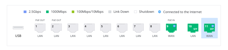

Willie,
Sorry I should have said it is the GWN7003 port 11 is enabled and all it says when plugged in is disconnected. I do have the latest firmware installed.
hi Richard .

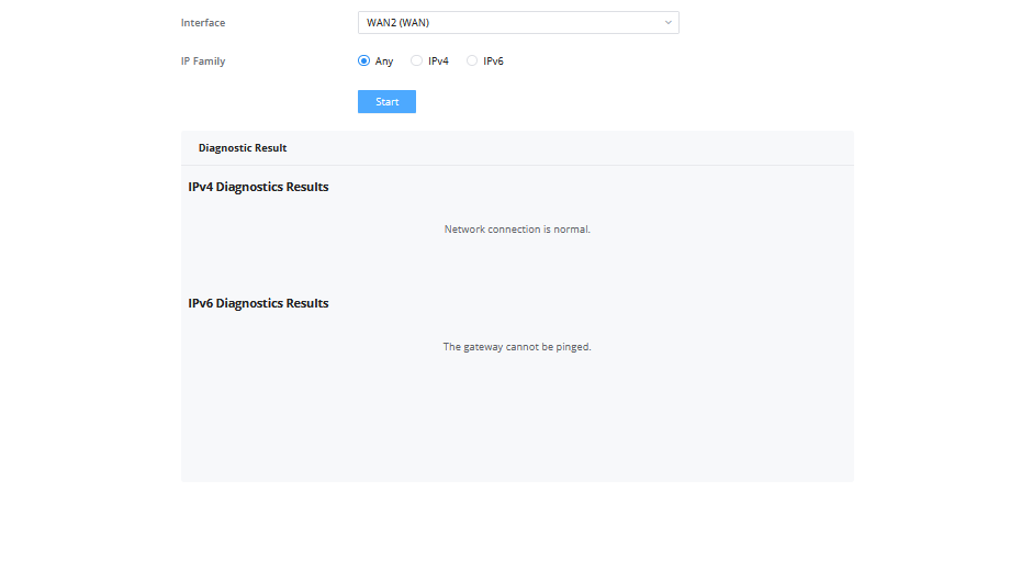

share screenshots similar to these of your GWN7003 port info.

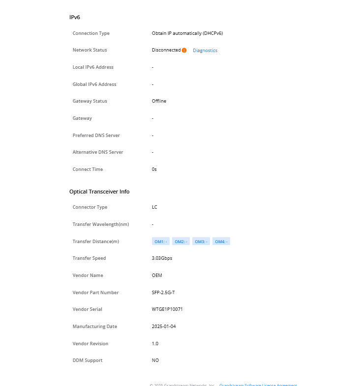

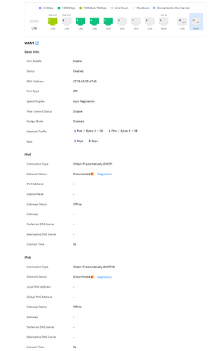

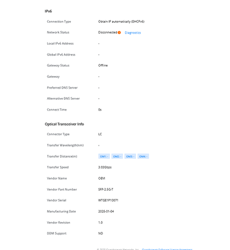

mosibda,
attached screenshot also notice even when connected to port 9 network diags shows it cannot ping the ipv6 gateway but ipv4 shows normal but port 9 seems to work fine.
is it normal or a bug that only 1 wan interface can have ipv6 enabled ?
