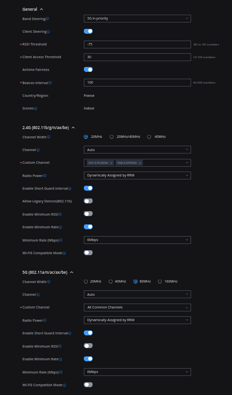

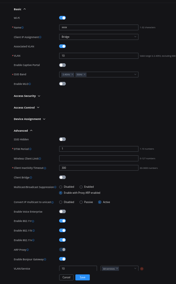

Hi all,
using 2 gwn7660 AP on my network and I am trying to find the best settings for my Wi-Fi.
Do you think I can improve my Wi-Fi speed / coverage ?

Lots of factors will influence how well your wifi set up works. That being said, GS default settings usually work well and it comes more down to placement of the AP and objects around it. If you have a lot of IOT stuff, you will probably want to keep a separate SSID just for 2.4ghz devices and limit the channel width to 20mhz.
You can also do a site survey with your current set up to see what other APs are broadcasting a wireless signal and set your AP settings to something not in use.
Ok thanks, I’ve change so many things on console, do you know if we can have the default value for earch item ?
How do you manage them, locally or do you use GDMS/GWN to manage? If local you can reset to factory and they will pop back up with the default SSID on the back of the unit. Via GWN/GDMS you can choose reset from the menu to default the AP settings.
