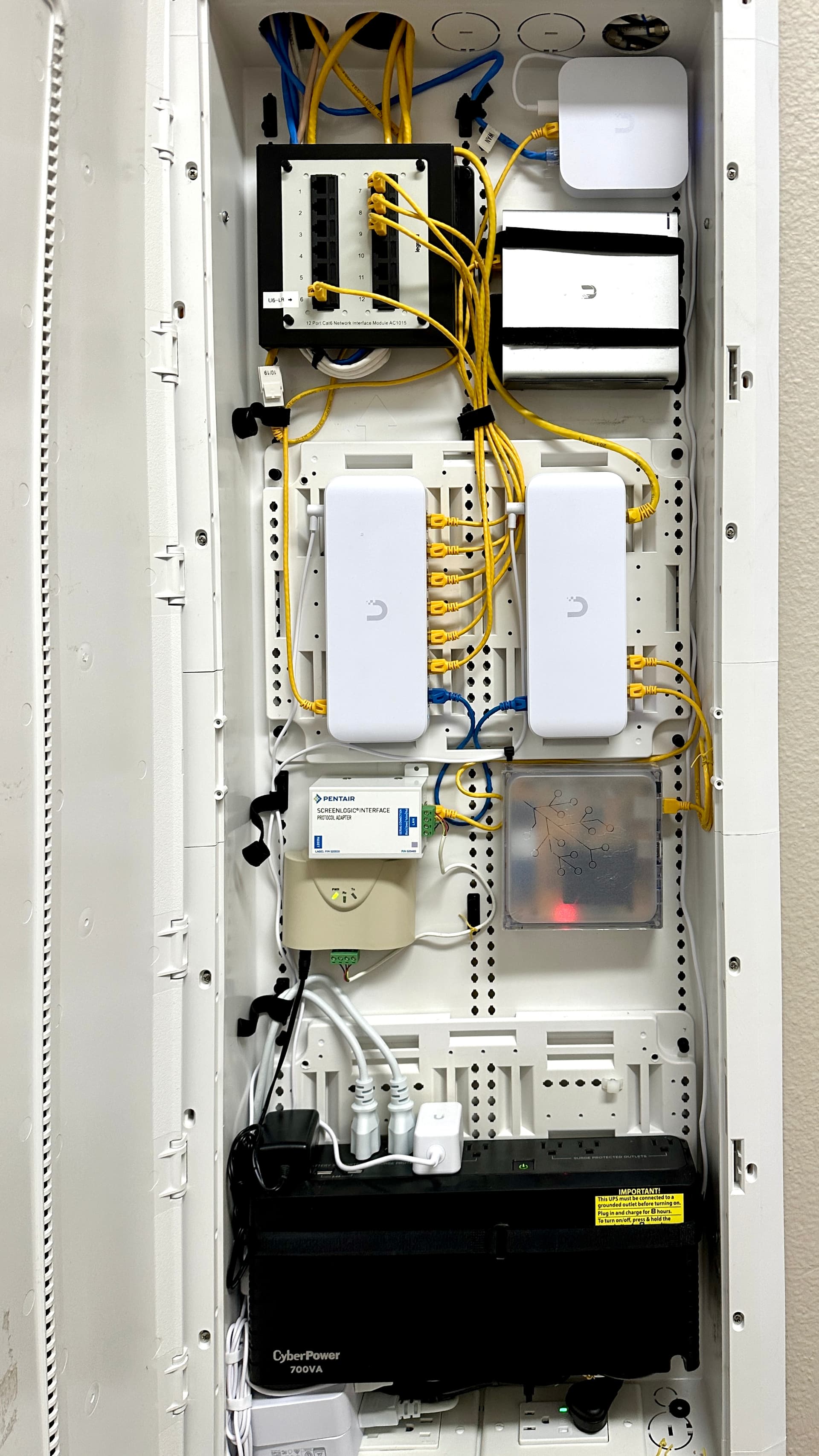

Finished replacing my two Unifi US-8-150w 8 PoE, SFP (gen1) with the two new USW-Ultra-60W Ultra 60W switches as I showed in my above diagram and everything works like a charm. I am very impressed with the switches. The budgeted 52 watts is plenty for the number of cameras, cloudkey, etc. I run PoE off the switches. The space savings is incredible, which allowed me to install a CyberPower 700V UPS/Surge Protection battery backup (see at the bottom of the pic). I am including a pick of the inside of my media cabinet (my personal home setup).
Great job! Very clean! You should post this in the network pictures section too!
