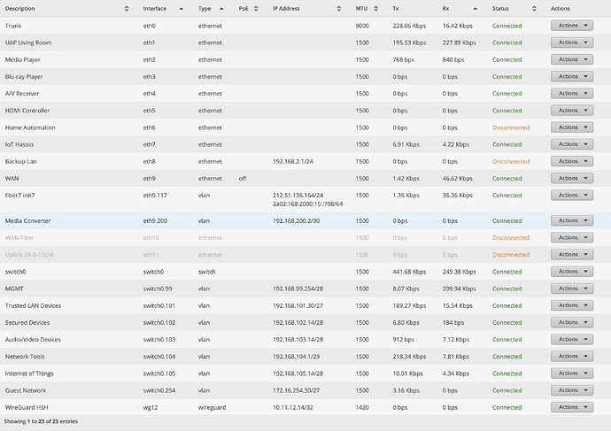

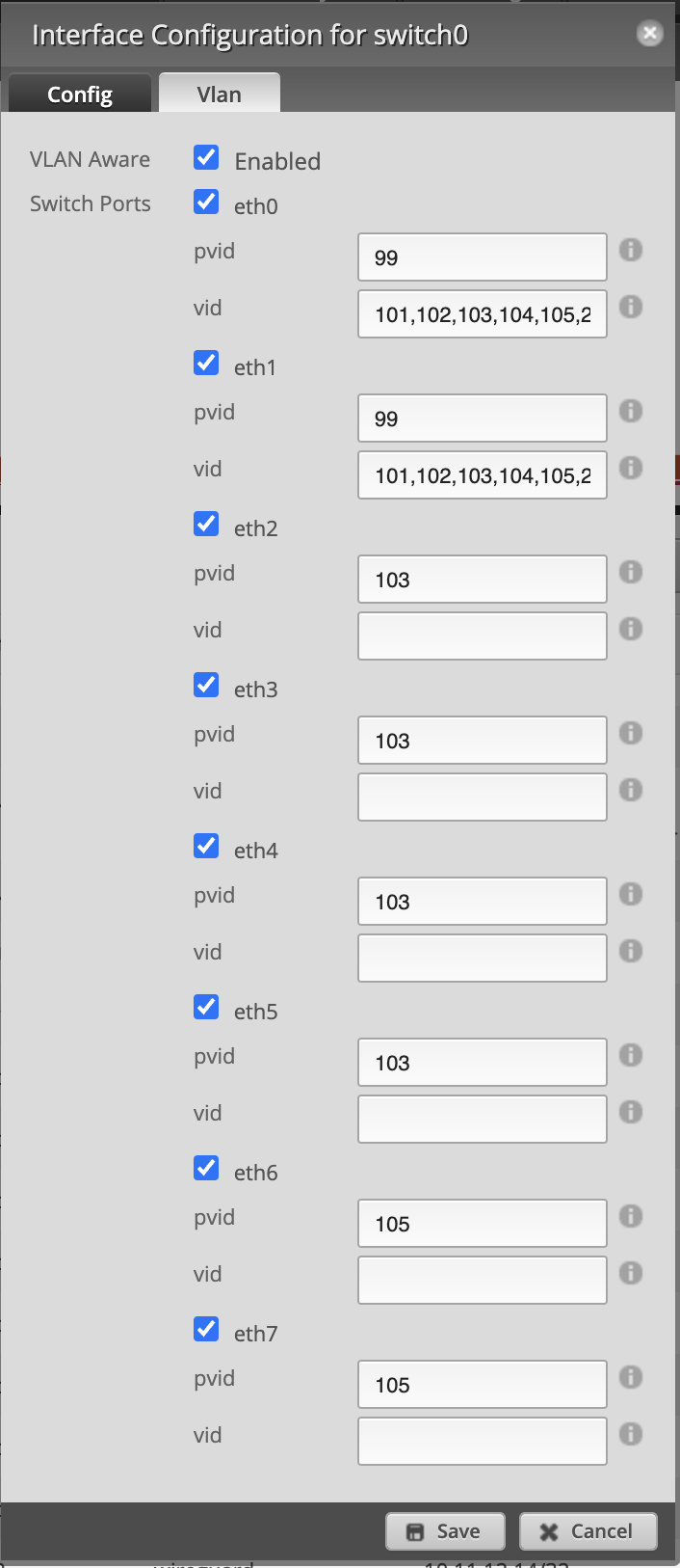

I don’t have an ER-12 handy. Can you post pics of the interfaces screen and then on Switch interfaces click configure, and then submit screenshots of the VLANs tab on that configure screen.
Hello Willie
Here are the requested screen shots. Thank you for your help.
Regards Thomas
As long as the SFP interface is in that Switch0 config you’re golden.
