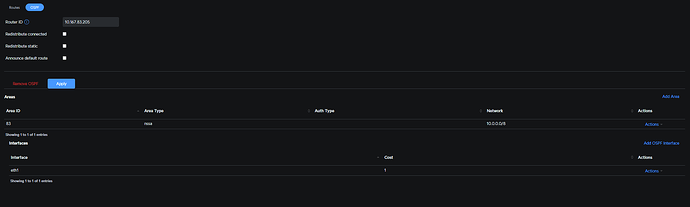

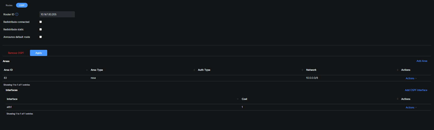

Can you post screenshots of your OSPF configuration?
Issue was solved. The config was all correct but I had to have the provider reconfig the handoff negotiation along with some multiple restarts.
