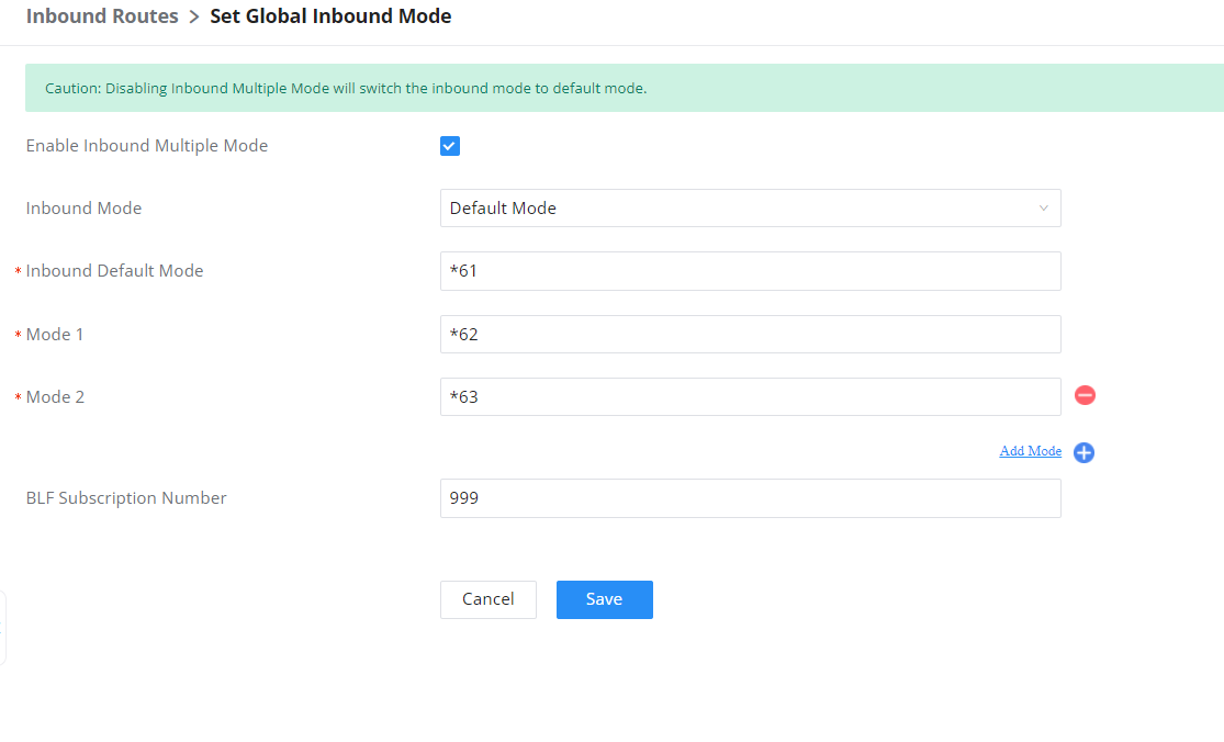

When you create your inbound routes on the UCM, set up inbound multiple mode. You can switch between the modes by dialing, *61, *62, *63 etc, for how many you have set up. You can change that *61 to something else, these are just defaults. The BLF # can be added to a phone so you can see the status. It just goes red or green. Green is default, red is one of the other modes.

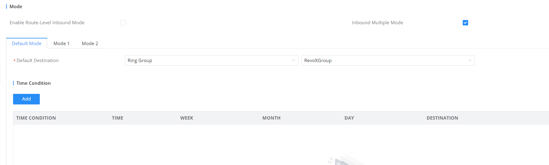

On your inbound route page settings, you would check the inbound multiple mode button and then you can tell the inbound route what each mode should do.
Thanks. That’s what I’m looking for.
