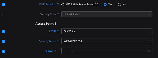

We use a template in GDMS to ensure the APs don’t lose their WiFi after a reboot.

Make sure your phone is bound to GDMS. Create a template for the phone in GDMS and then add the SSID, password, and enable WiFi.
