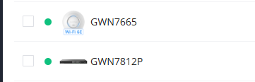

If it’s keeping the default ssid and you can connect that’s good. I assume you can browse out at that point? Try a different web broswer to reach it and make sure you put https in front, it should auto do that but you never know. IF you can’t reach it via it’s IP maybe try creating an account at gdms.cloud. Free to sign up and use. Add one of the APs there and see if it comes online. It will show a greenlight next to it like in this picture.
You can update the firmware that way, which may help your issue of not being able to log in locally with its IP. You will have to take off gdms.cloud after if you just want to log in locally to the web interface.
