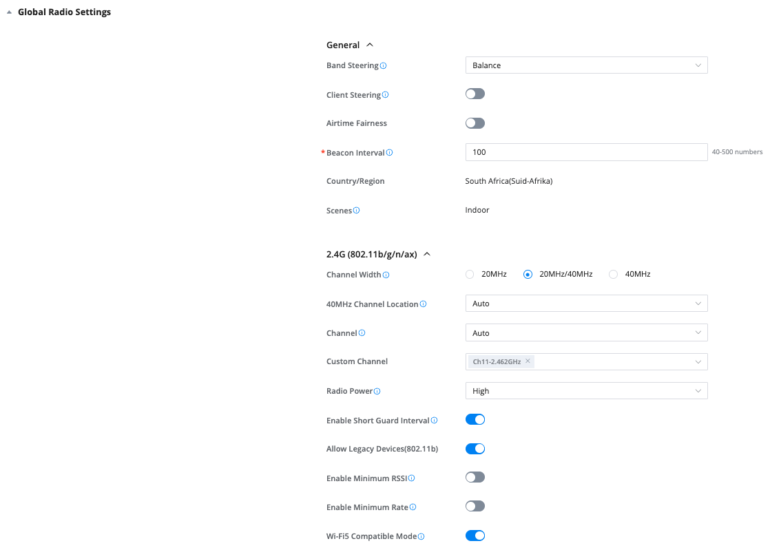

Screenshot 2024-11-08 at 16.49.43
If I may offer a couple of suggestions…

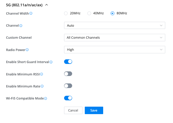

At the very top you have band steering set to “Balance”. That may be causing most clients to connect vis 2.5ghz right now. Disable that for testing and see if that helps. Try disabling “Enable short guard” for both 2.4Ghz and 5Ghz. Additionally, unless you have 802.11b client, I strongly recommen’d disabling “Allow Legacy Devices”. That can seriously slow things down. The same goes for “WiFi5 Compatible Mode”. You don’t HAVE to have that one for most all WiFi 5 devices.
Give those things a try and let us know!
thanks , i’ve made the changes as suggested and will test again .

Besides the suggestions from @rutman286 set your channels, and power manually. Don’t use 40Mhz on 2.4ghz. Set minRSSI to -74 and you haven’t told us anything about the switch these are plugged into or the client device you’re using.
