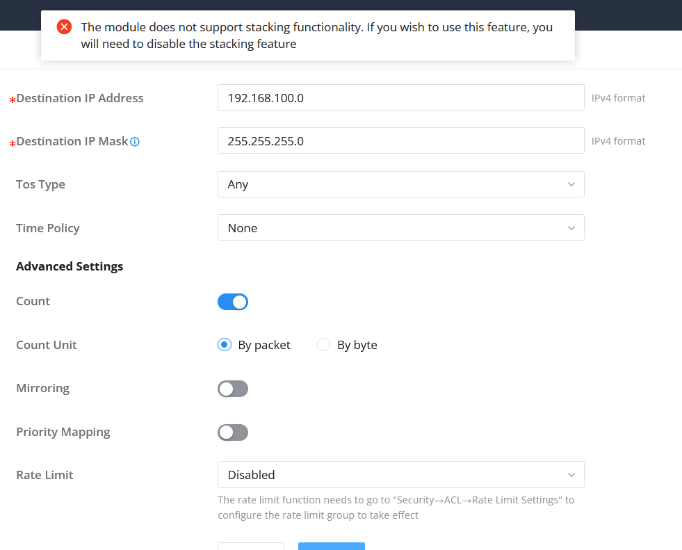

Do you have step by step process?
As well when a ACL policy, I am getting below error.
