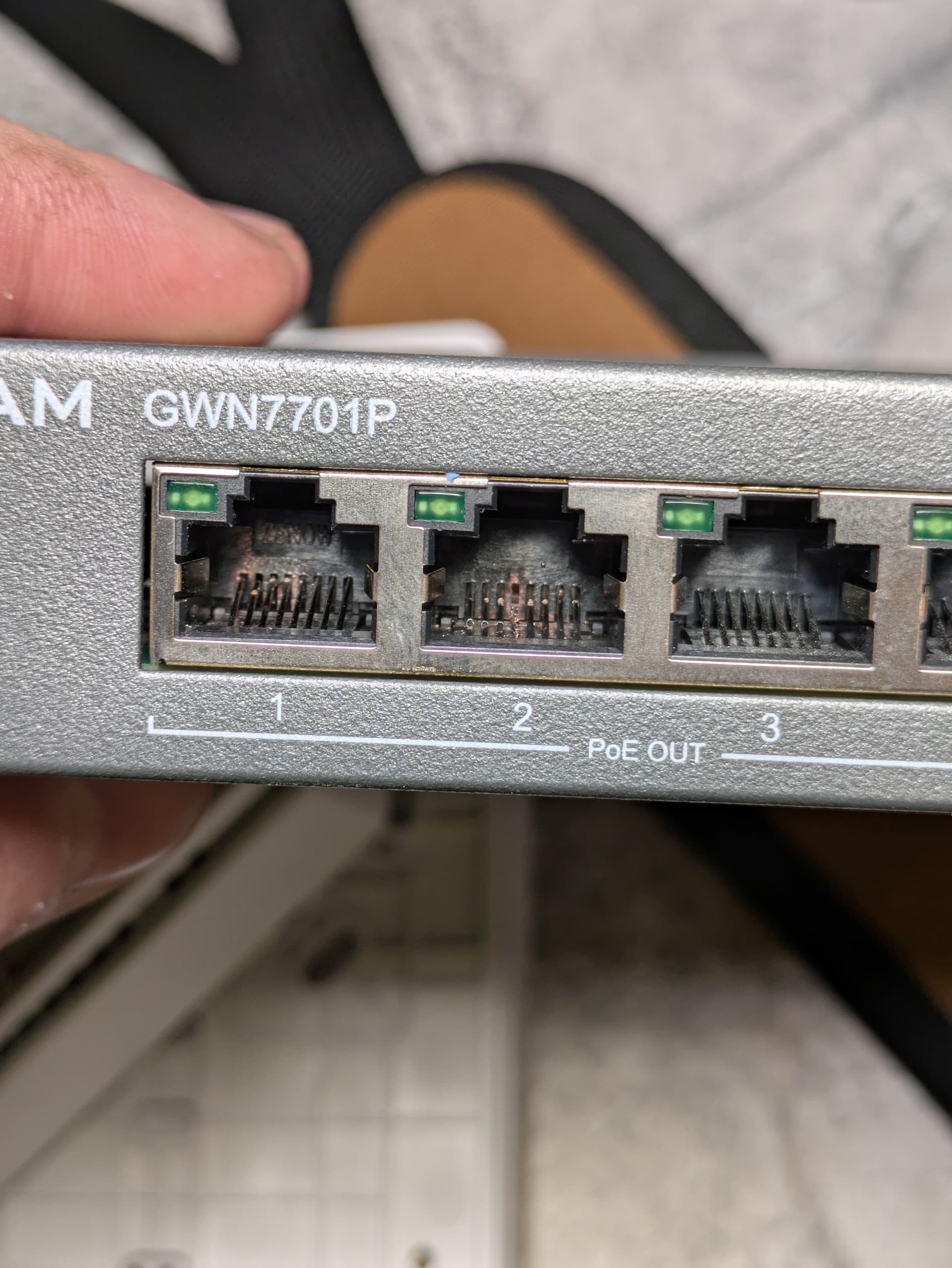

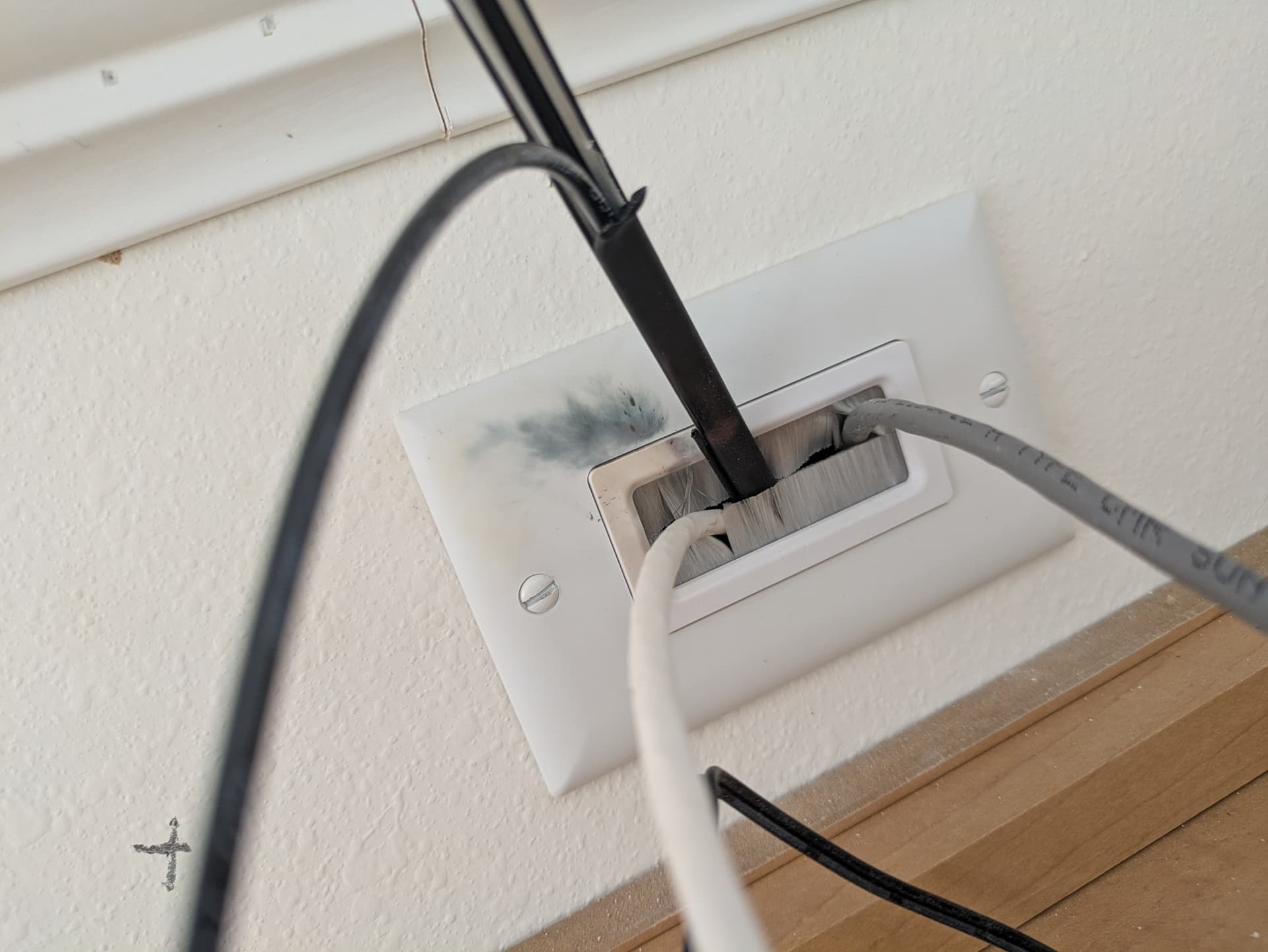

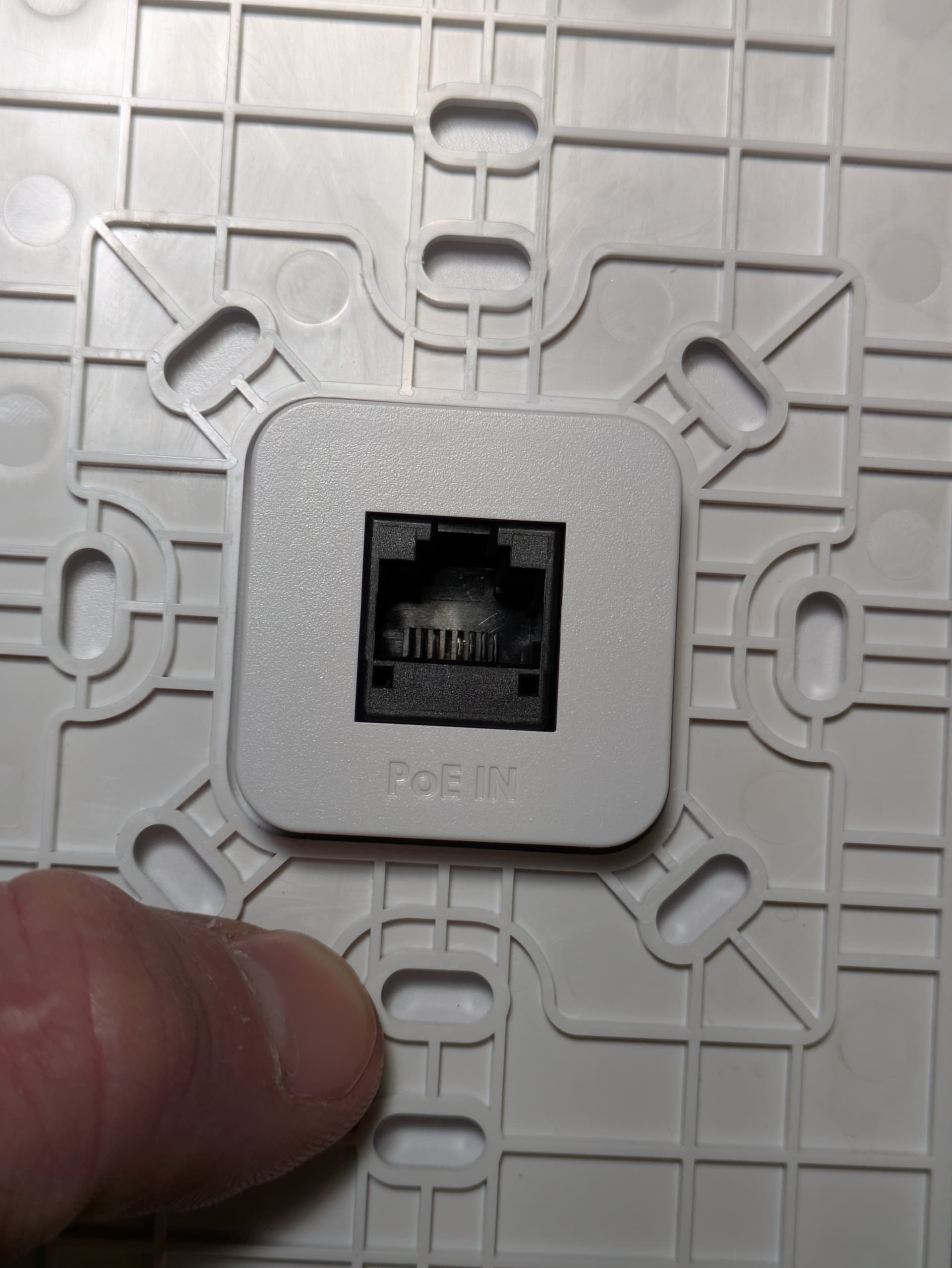

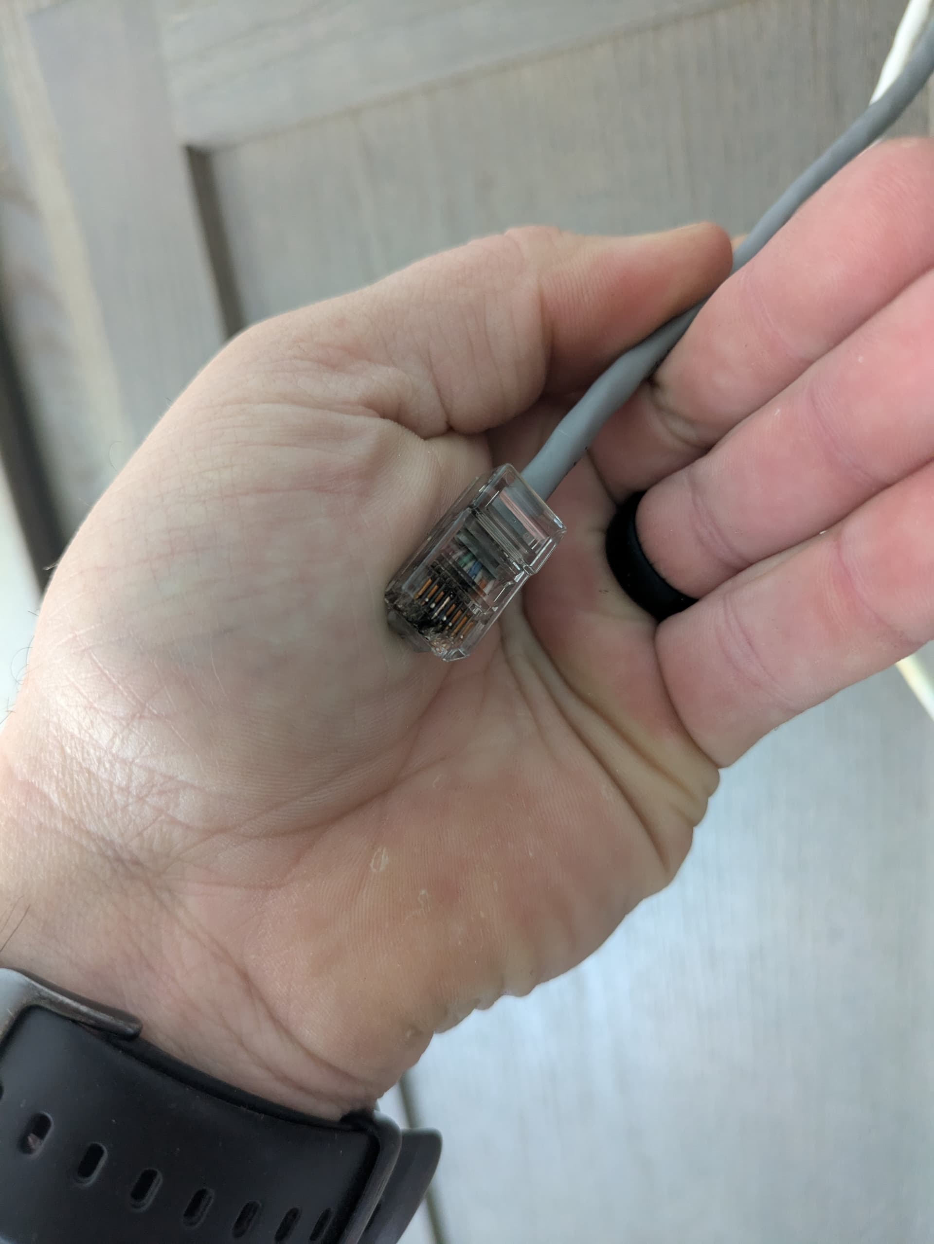

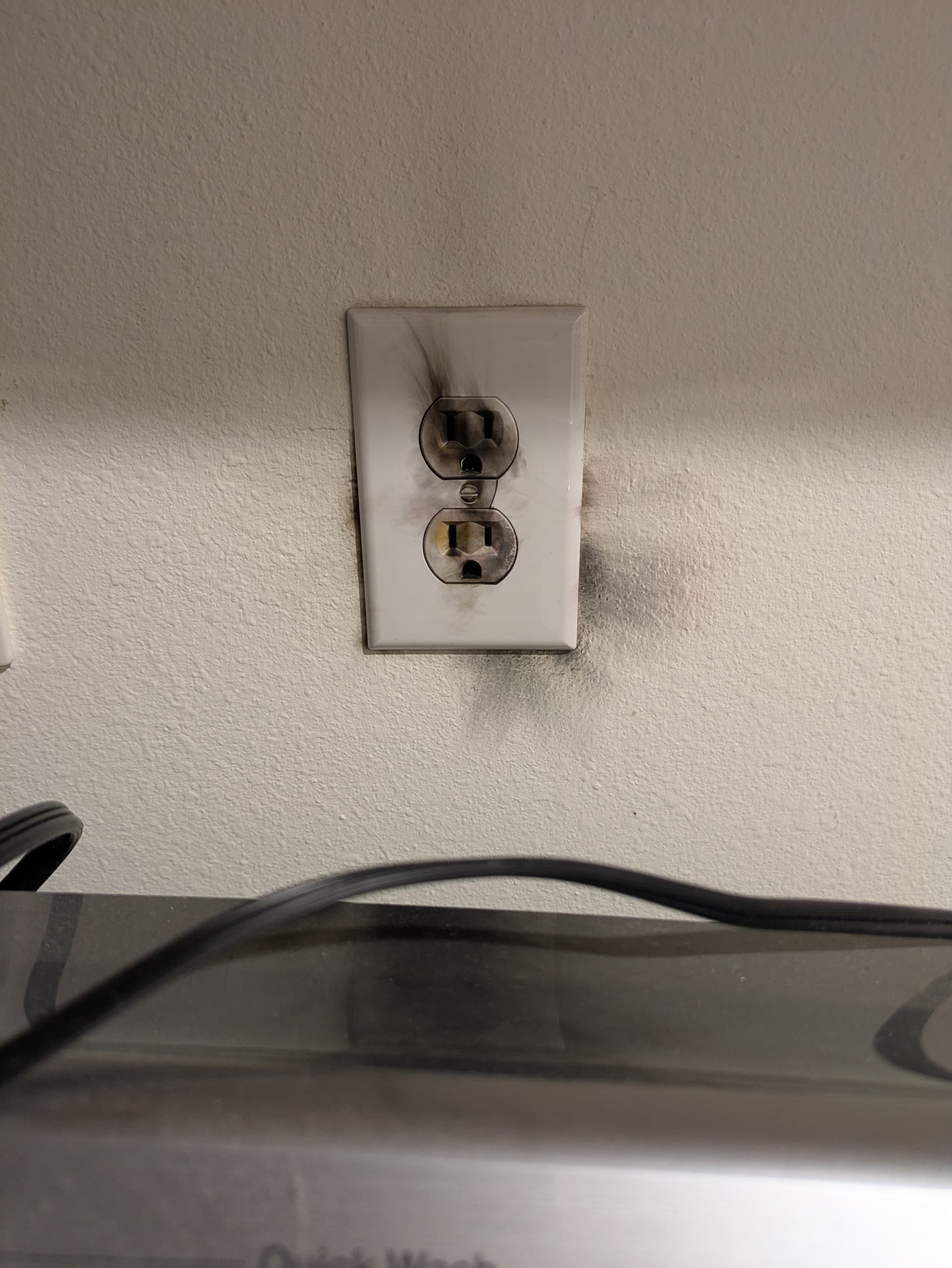

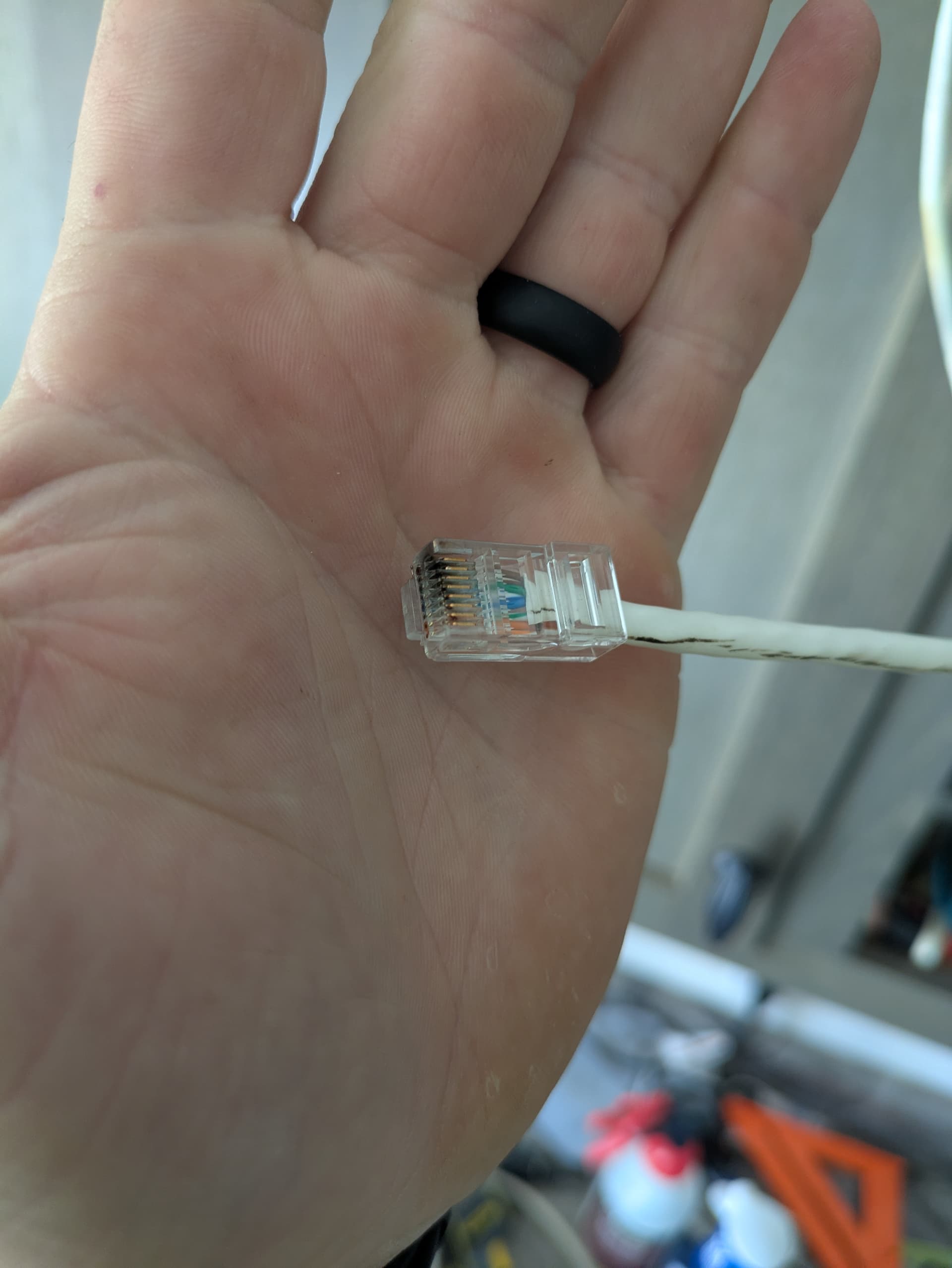

Is their anything that can help or save network equipment from a lightning strike. All this equipment is/was in my personal residence. House didn’t get hit but it was very close. Surge protector and equipment grounded . Lost 1/3rd of our can lights and 2/3 of our kasa switches. The outlet was the last one on the circuit but the gear was not plugged in to it, but same circuit.
Ouch, that looks bad. I’ve lost lots of equipment at my current office due to lighting strikes. I have equipment grounded. When it hits close I don’t think anything can stop it.
That’s what I have read just wanting to check with others. On the plus side guess I’ll upgrade from the 7002 to the 6010/6011

We have a whole home but everyone thinks it was so close that it jumped into the house (Like an emp), and didn’t come through the main feed.
Yes I need a ups just hadn’t bought one yet, sold the last house with all gear and ups in place. I kind of figured the ups would have got taken out also.
