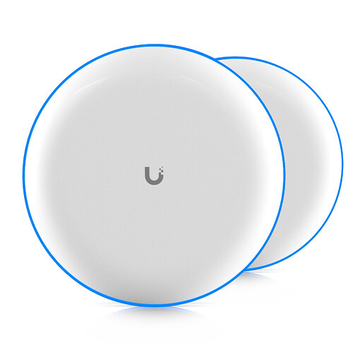

I have had good luck using the ubiquiti nanobeams, with lots of trees the nanobeam 2ac would probably have better signal. I use the 60ghz bridge at my house that @rutman286 mentioned, crazy fast! But they do need line of site with nothing in-between.
