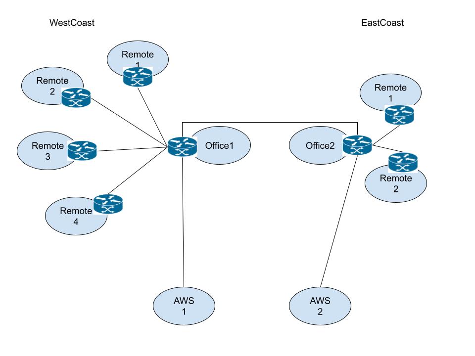

Afternoon all - I am currently at the point of replacing my older Cisco ASA’s for my company and wonder what kind of thing(s) others would consider/suggest. I currently have my network split up into two separate hubs connected with a VPN (as well as VPN’s connecting remote spokes to the HUB):

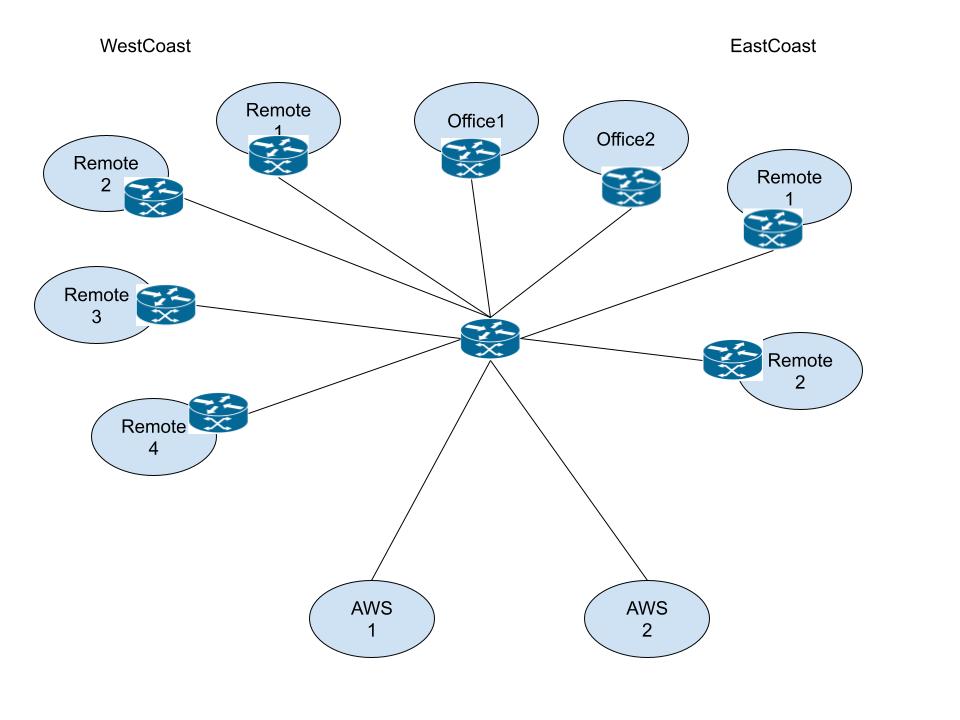

One of the main problems with this setup I would like to eliminate is when either HUB (Office 1 or 2) goes down, the attached remote facilities to that HUB also cannot function properly without difficult manual workarounds. I believe I’d really like to have a Cloud based HUB that all the facilities can connect to so if any facility goes down, it is only affecting itself and not the remotes connected to it. (Albeit unless the cloud hub itself goes down - then we’d all be toast - but i’ve been pretty happy with the uptime for hosted things theses days and believe we would have very little of that [fingers crossed]).

Thanks for the input and suggestion - I actually did have a conversation with a Fortinet sales guy and he had a network engineer on the line with us that kept wanting to put a primary router in Office1/Office2 - which I thought would defeated the point of having a “cloud” router - he was sure I did not understand how SD-WAN’s works. Nevertheless - they were supposed to put something together for me and I never heard back from them again. Just got on their mailing distribution list! Thanks again for the input!

This may seem like a silly question, (and may also indicate why the Fortinet network guy felt I did not understand SD-WAN) - but I just watched a few SD-Wan setups with Fortigate and all them are setting up redundant Internet connections. All my locations have one internet connection each (no redundancy here) - I was wanting the SD-WAN set up so if one of the hub locations falls, it didn’t take the adjoining locations with it. I’d think redundant internet connections would potentially take care of that issue with out the need of a “cloud router” or SD-WAN and maybe that’s a better approach (wouldnt put us in a single point of failure for everyone). If I were going to run redundant Internet connections at the Office Locations, I don’t see what I would need the SD-WAN for? I understand there are other benefits of SD-WAN, but those are not the primary reason for looking at this change.

Why not just connect all your remote sites to AWS and use that as the hub in your hub and spoke?
The routers that are used with our Hosted applications on AWS only allow one VPN to be connected to them. So the Meraki and the Sophos solutions are both talking about hosting a virtual meraki or sophos router on AWS that will be our HUB.
