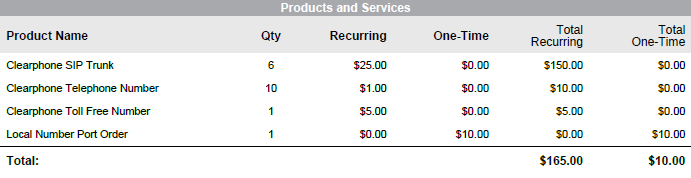

We’ll be migrating our current Samsung system over to Grandstream next week, and we’ll be using ClearFly. Here’s a screenshot of their quote for monthly services.
Funny thing…i worked with clearlyIP in the beginning to get a sip trunk connected to a UCM and told them the options to get things working!
How many total minutes do you use per month? There’s really no reason to have 6 separate trunks these days. We can probably help you fine tune this.
We handle about 600 calls per day. I’ve been watching the utilization through the UCM. We may adjust, but I’ve got to do some math to figure it out. Overage calls per minute cost vs monthly trunk cost. We peak at 6 quite often, but have only rolled over to 7 once or twice.

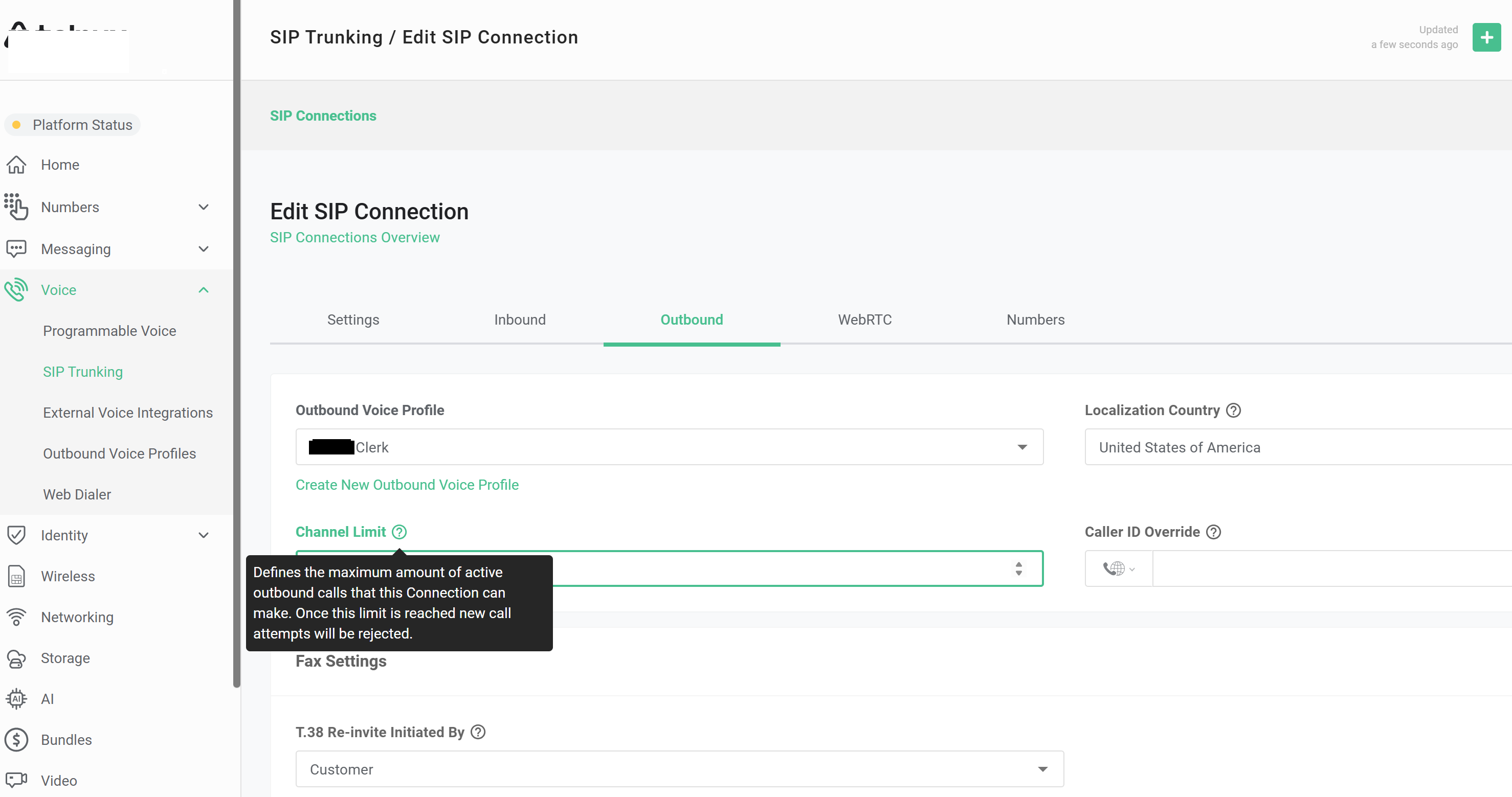

A standard elastic trunk from Telnyx allows for 10 calls paths at the same time.
That 10 calls per trunk can be expanded by contacting Telnyx. Also you can use multiple trunks.

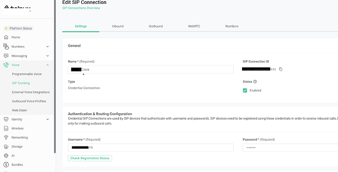

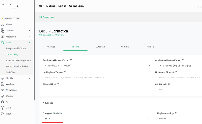

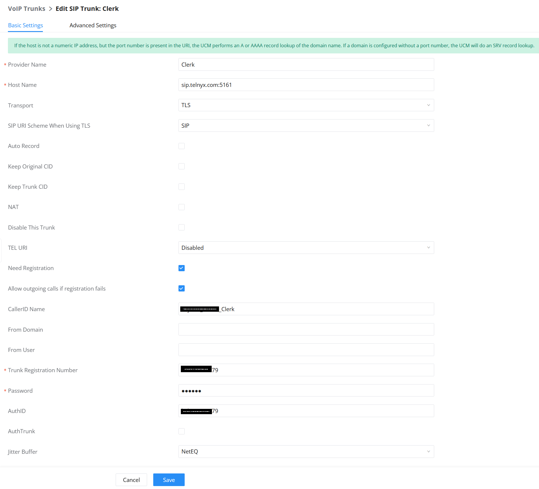

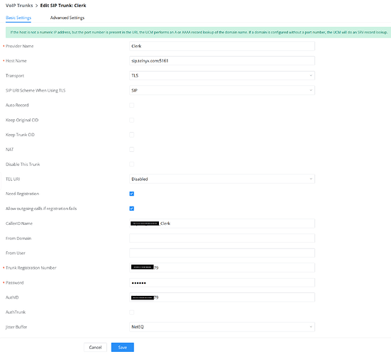

@James

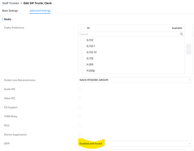

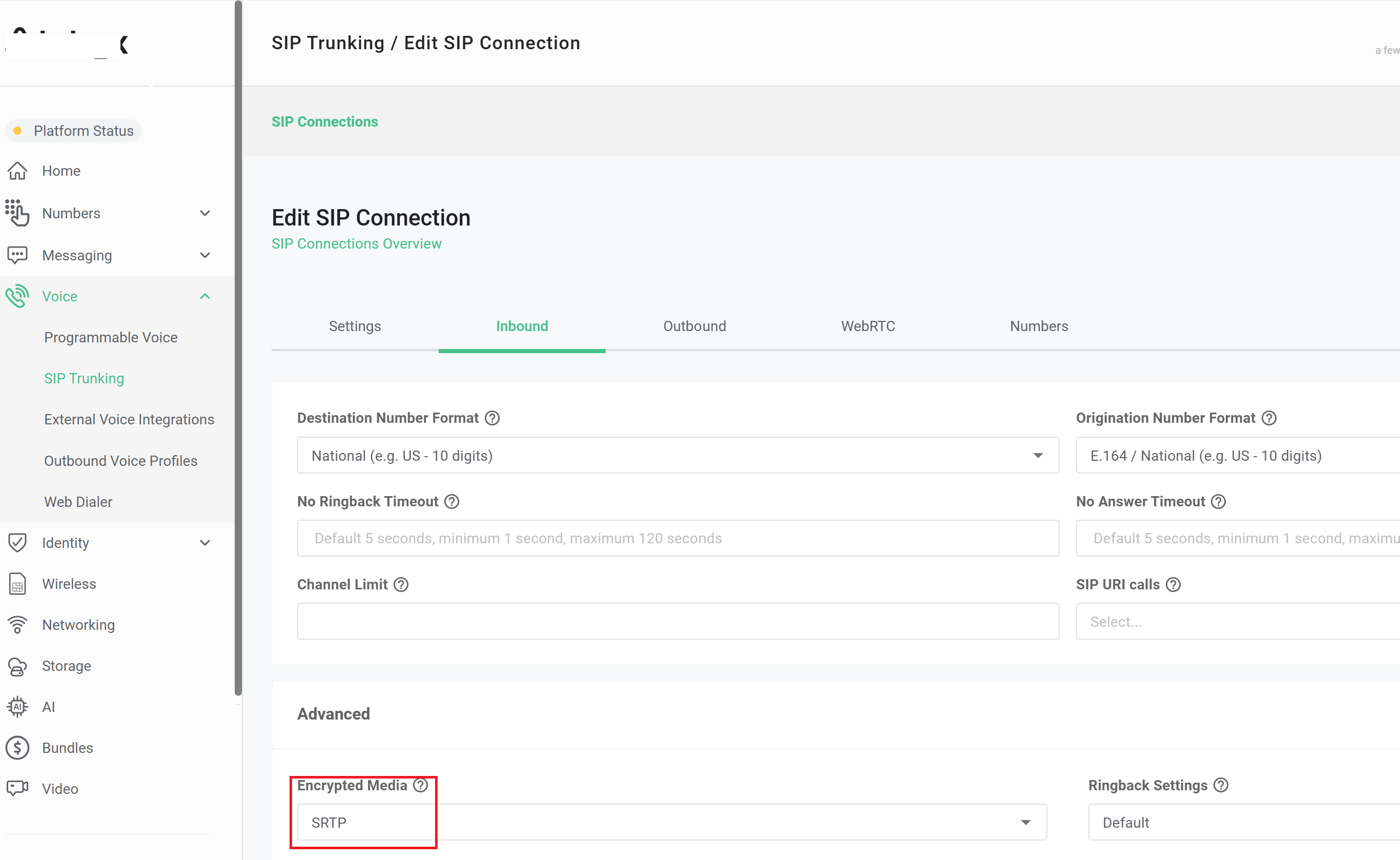

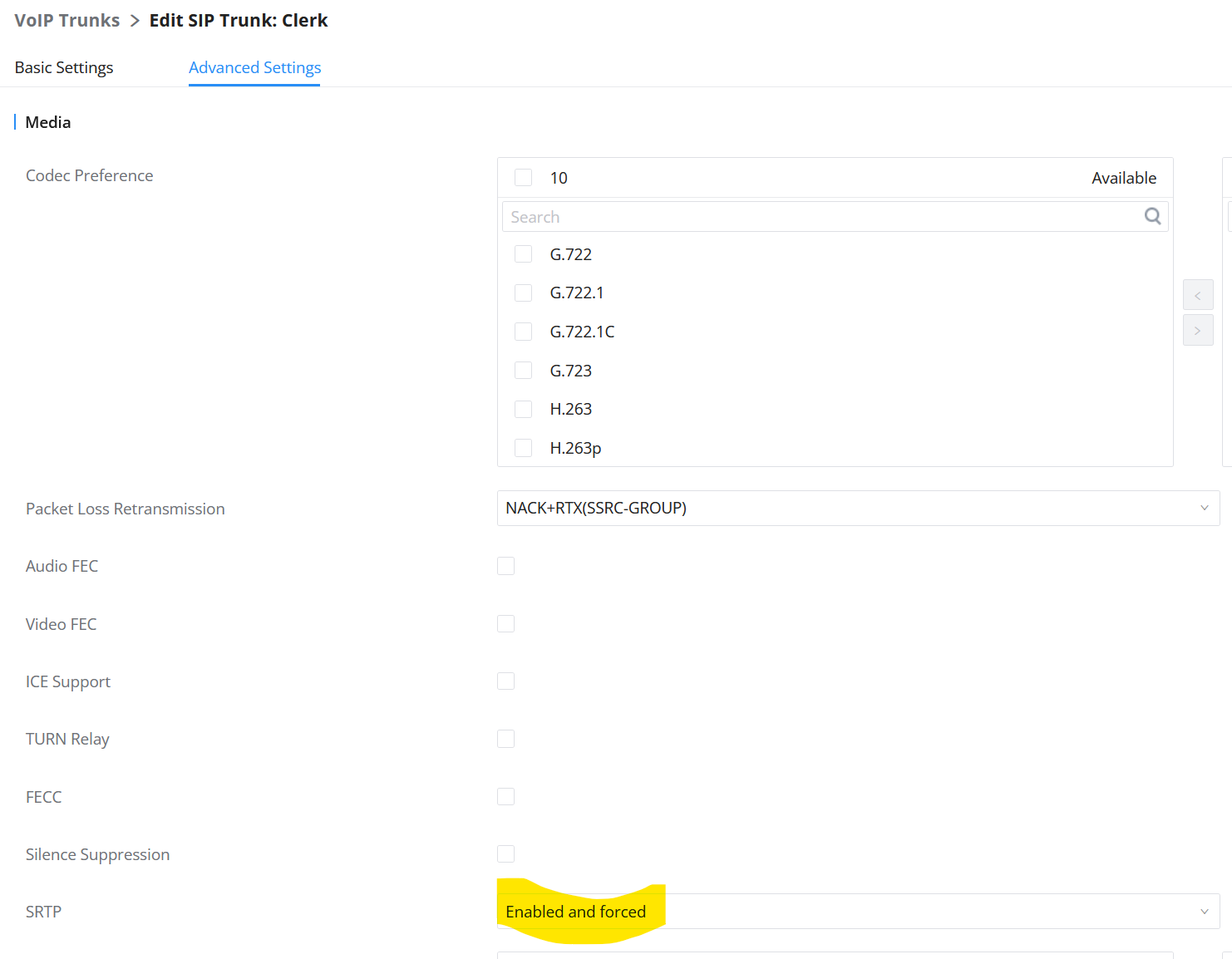

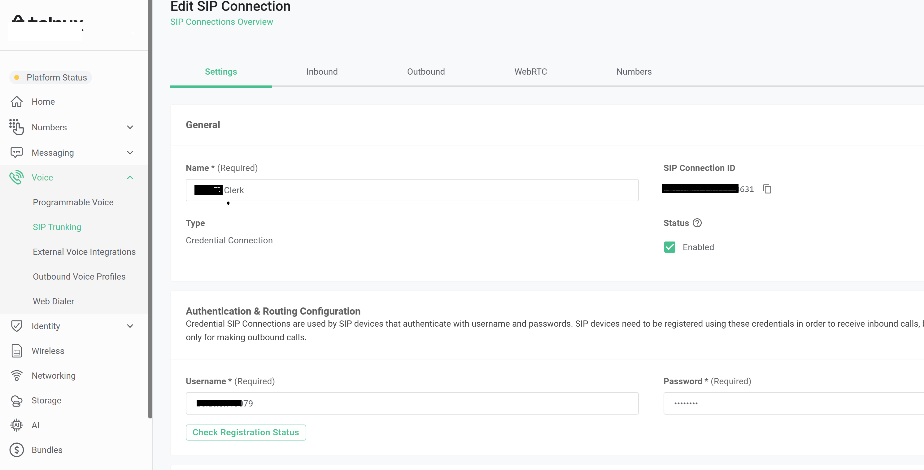

Basic setup is really easy, sip server IP or FQDN, username and pw. They also offer TLS/SRTP. and that setup is not bad either. I will get some screen shots of both types and post them here.
@RConger,
Have a look at your minutes and then do the math, I would be surprised if didn’t save a bit with Telnyx elastic sip trunking. Even if you stay with the per trunk billing, I think Telnyx only charges $12 per trunk. You would still have the $1 per DID, and the $1.50 for each E911 listing. If most of your calls are inbound, you can save even more, Their pricing for Incoming calls is $0.0035/minute, and outbound calls are $0.005/minute. The only downside I have found it they round to the whole minute. That really does not make a huge difference though. Calls to other Telnyx numbers are no charge. Also they do not charge for porting in numbers.
This is how we always sell the systems and we 100% of the time beat any CLOUD based and/or per handset systems.
