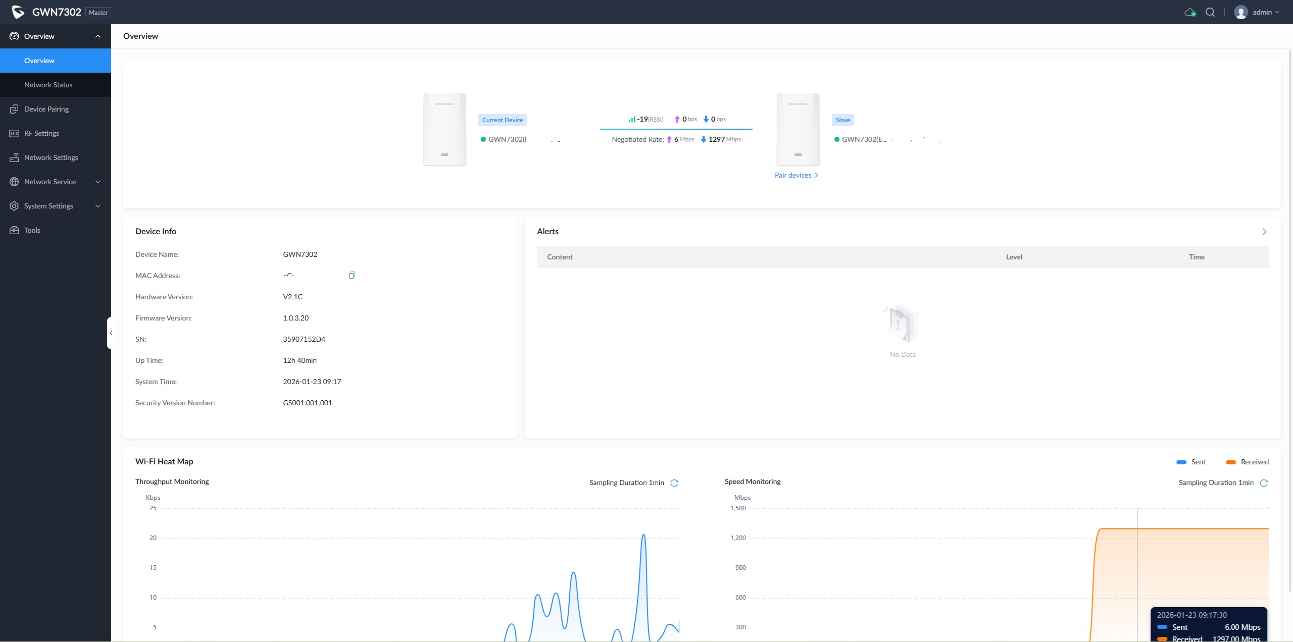

Got 2 GWN7302 to install sometime today or tomorrow. Here is a screenshot of the interface. Have not had much time to mess around with it, seems to take a bit to link up so if you do get one of these be patient at first.
