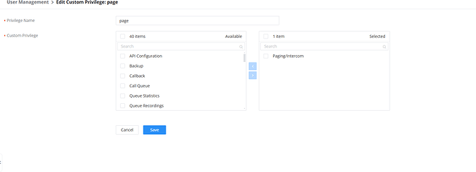

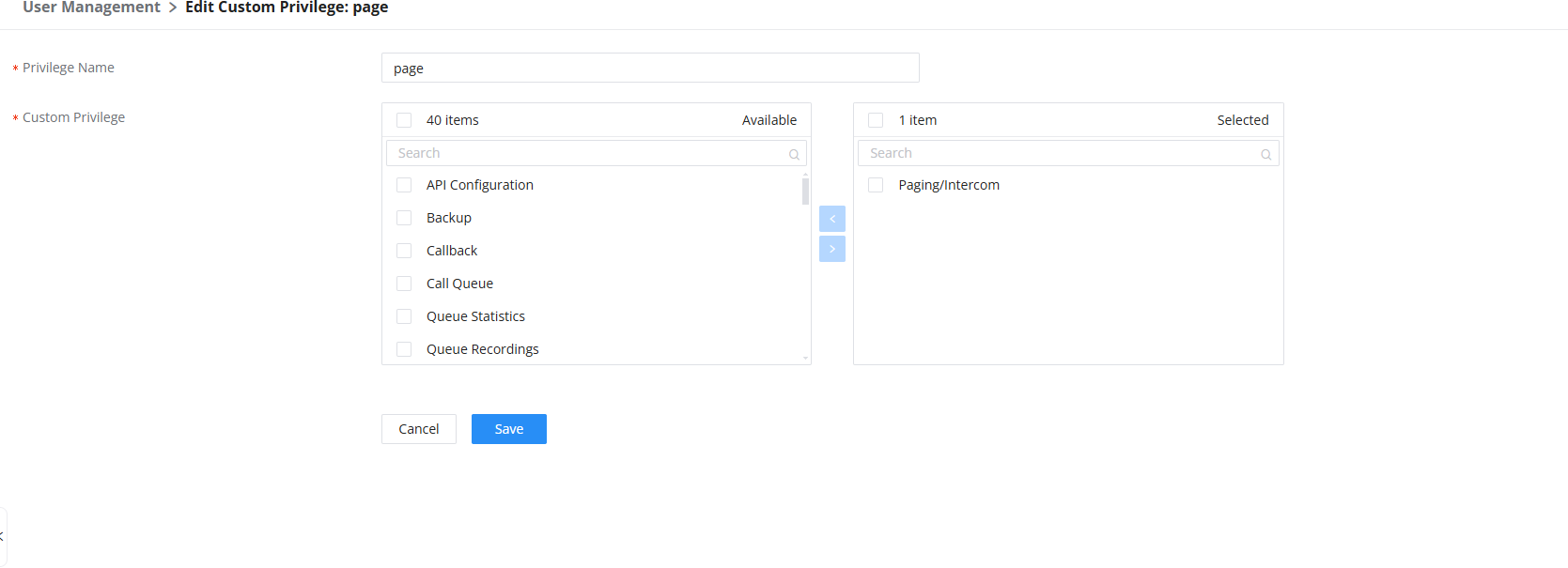

You could give them just access to the scheduled paging by setting a custom privilege. Create a new user and set the privilege to the custom one. They will still be able to see the other page information but will be limited to just that.
