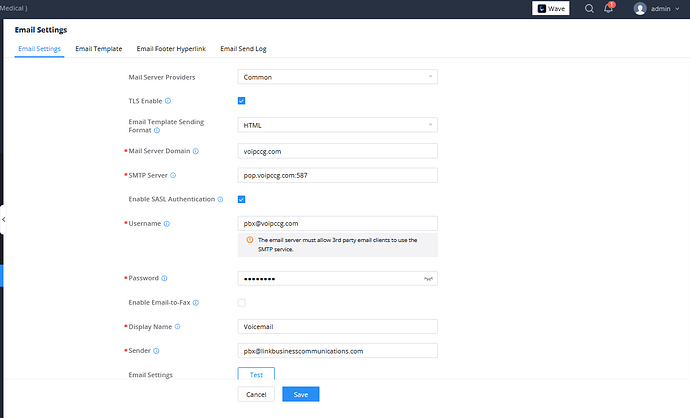

I’m attaching a screenshot of my email page.
For this service, I use Dotster. But can’t see how they are at fault since the send logs show no email as sent, or even deferred.
