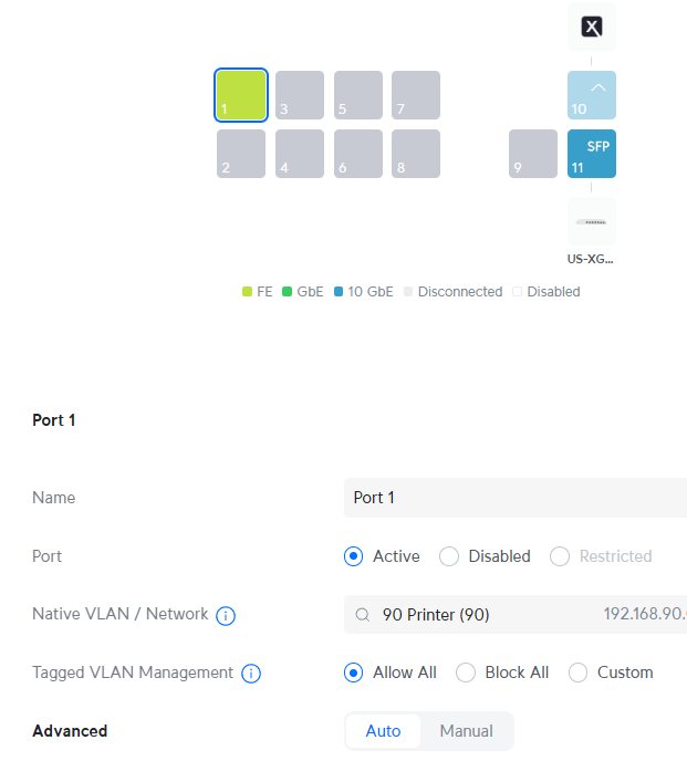

Ok – so the port that the printer is plugged into – is the network on that port set to just the printer network for the native/untagged VLAN?
Yes I believe it is, current i still have all other vlans allow, i did also try it will Block All

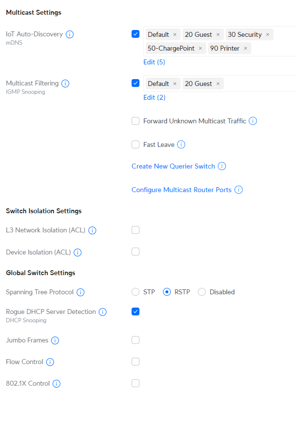

Do you have mDNS turned on for the main LAN and the printer LAN? What’s your firewall rule look like that segregates the networks?
Yes,
